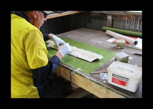

Remembering how hard taping inside the nose bowl was I decided not to tape the Canard brace, but copied the plans method of fitting the nose sides.
I covered the foam join with masking tape, prepped and 1 x BID over the underside of the brace, leaving a 1" unwet overlap, pinned to the underside with nails. Left it for 1.5 hours until a bit tacky.
Roughly floxed the brace in position, released and wet out the overlap. Was a bit short on one side, so put a small tape there.
Camera got recalcitrant, and no usable pictures of the part in place.
