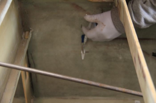

Applied flox fillet to inside of nose bowl join to fus with a broken hacksaw blade, and filled gaps on the outside.
Attempted 2 x 2+2 tapes, but found it almost impossible to get into the acute angle. Ended up taping about 50% of the join on the inside, and all the way on the outside.

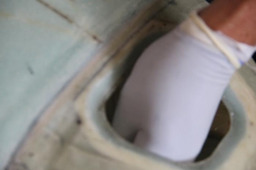

Micro'd in the static source pipe, injecting the runny micro with a syringe.
Applying flox fillet. Feeling a bit like a Gynecologist...

Static source pipe in
