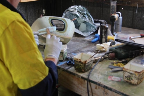

Floxed pitot assembly to NG-31/nose.

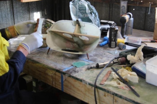

2 x BID over all, overlapping 1" onto NG-31/nose bowl
Applied 2 x BID tapes over all NG-31/NG-32/nose bowl joins, leaving me with a scrap of BID smaller than a kid's hanky. Laid the tapes up over peel ply, then transferred them into place with a mixing stick. Worked well.
Didn't put on the nose for cure, as some tapes got in the way. Fingers crossed.
Floxing up the pitot
Taping, taping
Taping, taping
