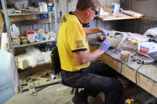

Trimmed NG-32 and floxed onto nose bowl.
Cut hole in nose bowl for pitot.
Prepped pitot, 5-min sealed the end and taped up the dynamic port.
Shaped some blue wing foam scraps and 5-min to pitot
Floxing in NG-32
Cutting pitot hole
