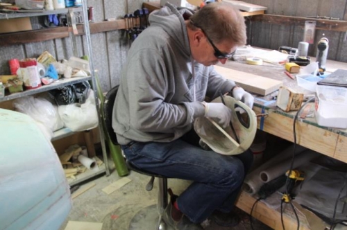

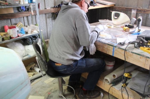

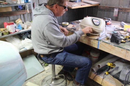

Trimmed excess flox. Was quite pleased to see the resulting gaps filled by the flox were minute, and minimal blobbing.
Made another sucession of mdf templates for NG-32, then cut the final out of 1/4" hoop pine ply.
Glassed NG-32 2 x UNI @ 90 degrees, (plans say 2 x BID), and peel plied.
Used leftover resin to apply fillet to NG-31/nose bowl join.
After work attempted knife trim NG-32. No-go, was too hard already.
Template #3 or so
Stipple, stipple
Applying fillet
