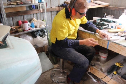

Trimmed layups. Kept tolerance of can-holes tight, uncertain of what the resulting angle and orientation of the cans will be.
Floxed NG-31 to nose bowl. Wasn't game to tape it as everything kept moving around. Fixed to nose to ensure cures in the right shape.
Profiled the flox fillet through the Ballast Hatch with a rounded off hacksaw blade.
Trimming NG-31
