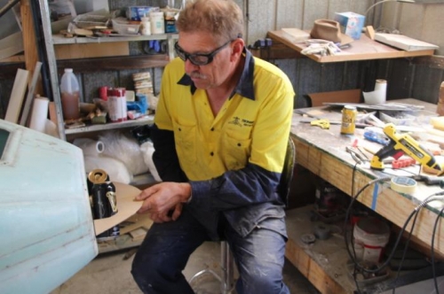

Drilled and dremelled out Ballast Hatch window.

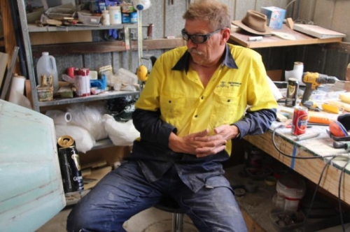

Spent more time thinking about the bulkheads within the nose bowl. Decide that rather than using foam I will make a series of NG-31 templates from 1/8" MDF, edging toward an accurate profile. THEN cut out the foam. I want a close fit and no gaps. I expect I will only need 1 x 600ml and 1 x 375ml in service, and I can put extra aft of F-0 for the first flights. MUCH easier to fit two cans in the Ballast Compartment, leaving more room for the submerged pitot and a single NG-32 on the centerline.
Glued a couple of cans where two will fit, and checked clearance through hatch. Angled a bit forward they fit fine, and will be much easier to manipulate.

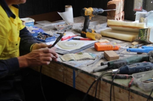

Glued some foam blocks on the inside of the nose bowl, to locate the NG-31 templates. Cut one rough, then stick plasticine around the edges to define the refined shape. Cut another template and trimmed a bit then roughed out holes for the cans. Glued bits of MDF around 1 can until it looks good, and made another template. Then wonder how I will support the bottom of the can, the nose bowl probably won't cope on its own.

Window cut
Window cut
Mmmmm. Two cans good.
Template #3, NG-31 take #2
