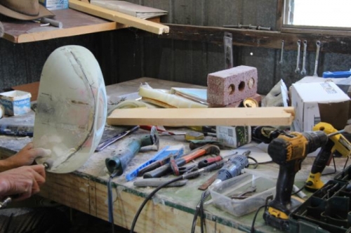

Removed remainder of NG-31/32.
Patched a couple of holes I punched through the nose bowl with 2 x BID patches on the inside, backed with duct tape on the outside.
1 x BID over Ballast Hatch window flange and weighted with foam.
Put nose bowl back on fus for cure with 4 x cleco. The nose bowl will go back on the fus for every cure cycle from now on, to avoid the warping that happened last time.
Back to the start with the nose bowl
Exterior layup on Ballast hatch window
Back on the nose to cure.
