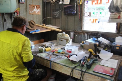

Can't find my shears, grumpy.

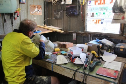

3 x UNI (DIY triax) over inner flange for Ballast Hatch window flange. Didn't lay down well, so weighted with foam.
Used leftover resin for filling gaps between NG-31 & nose bowl, using a hacksaw blade to form fillets.
