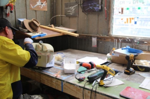

Finished upper brace foam, and hot glued supports on back so I can glass the inside in one piece.
Trimmed layups. Decided I didn't like the nose bumper as it was and trimmed the flange to 3/4".
Floxed NG-31/32 assembly to nose bowl. Now I look at it the gaps are grossly large, and bulk flox is going in.
Shaped Ballast Hatch window flange.
Filling up gaps with flox.
