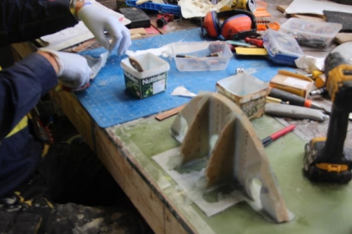

Trimmed layups, profiled flox around nose bumper.
Marked and cut inspections window in Ballast Hatch & cut foam for backing flange.
Cut up most of my remaining BID for tapes.
Micro'd backing foam to Ballast Hatch interior.
4 x BID around nose bumper, overlapping 1" onto bumper and nose.
Hot glued NG-31, aft side down, to work bench. Floxed and taped NG-32's to NG-31, forming a flange aft.
Started cutting nose upper brace foam. No BID left to cover it.
Marking Ballast Hatch window
Taping on NG-32
