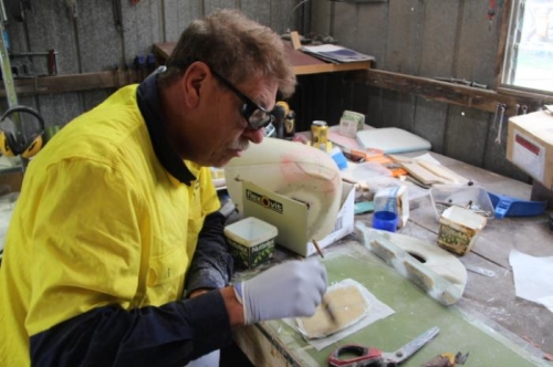

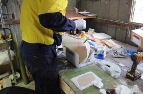

Ballast Compartment
Layed up 2 x UNI @ 90 degrees on both sides of NG-32, and peel ply.
Floxed Nose Bumper onto nose bowl, with a generous fillet.
Cut and filled flox corner over Ballast Hatch flange, and layed up 2 x BID tape over all.
Had a bit of resin left over, so taped top surface of Nose Bumper hardpoint to F-0 with 2 x UNI @ 90 degrees.
1 x BID tape over part of nose bowl that was obscured by alignment tabs.
NG-32
Fillet around Nose Bumper
