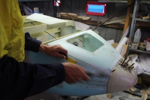

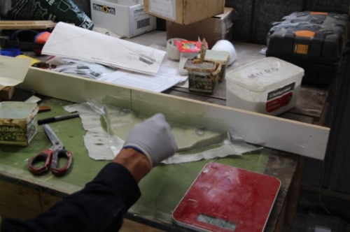

2 x UNI over bottom of NG-31, overlapping 1" onto backing board, and along the sides of the doublers, to enable a flox corner with the top surface.
Micro'd 1/4" foam doubler 1" wide onto inside of Ballast Hatch, secured with cleco clamps. Hung it on the nose to cure, to ensure the clamps didn't deform the part.
Knocked off the Nose top alignment tabs, and scraped off the hot glue.
NG-31 bottom layup
NG-31 bottom layup
