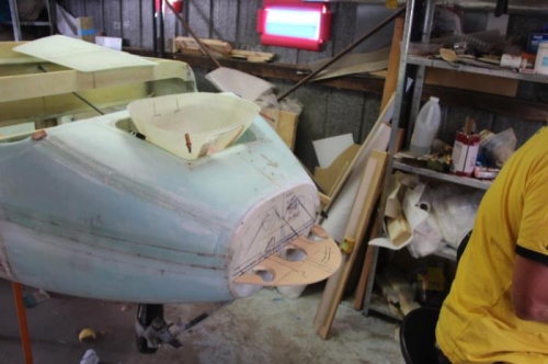

Brief Description:  Ballast Compartment
Continued playing with NG-31, and discovered the edge looks better if I put a foam doubler beneath. Plan a flox corner regardless to tie it all together. 5-min a new section STBD side to make it the same.
Taped off F-0 to make an upper surface flange, then decided to glass the bottom first.

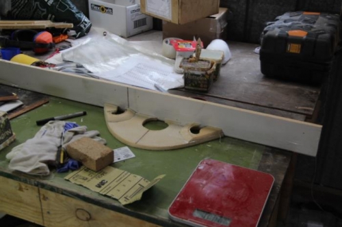

Micro'd doublers to bottom of NG-31, hot glued it to the table, butted up to a vertical board to make a bottom flange.
Cut 2 x UNI for bottom, supposed to be BID, but will apply at 90 degrees, DIY BID.

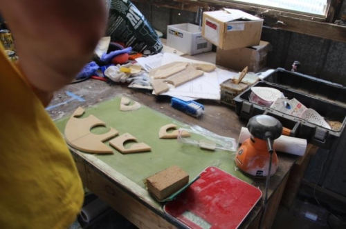

Happy with NG-31, but need a couple of doublers
NG-31 bits all done
NG-31 bits all done
Ready for layup, tomorrow...
