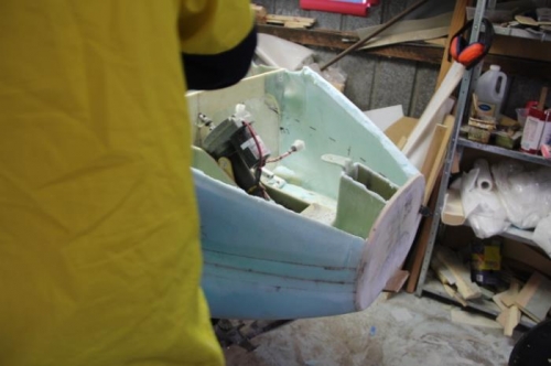

Prepped all and refitted nose top with flox
1 x BID tape over and under. Plans say do over after cure for some reason. I did leave a bit untaped where the alignment tabs are.
Running a bit low on BID scraps now.

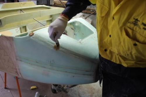

Floxing up the joins
Taping up the join
