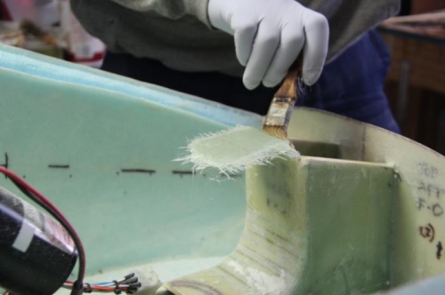

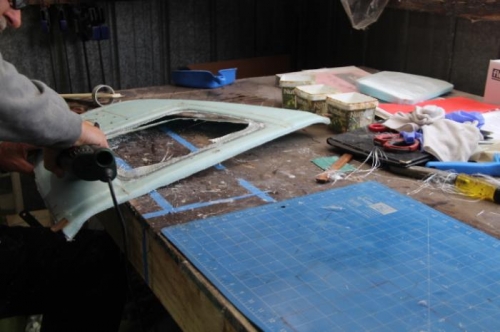

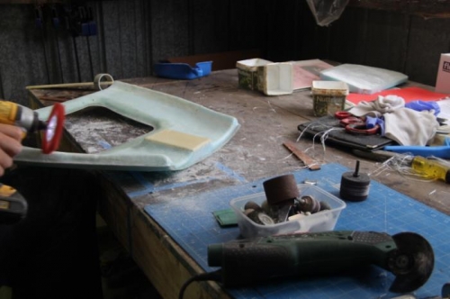

Trimmed layups and sanded transitions.
4 x BID bracket is ridiculously flexible. Applied 6 x BID & UNI in alternating layers above and below. May have overdone it a bit.
Master cylinder bracket
Trimming the flange
Sanding the transitions
