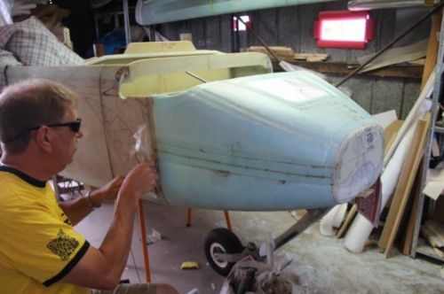

Trimmed layup. Left a flange at the front over F-0, separated with a utility knife. Some of the box tape went a bit manky and stuck tight, and there is a little glass overlap which I'll deal with later.
Cut nose top off and started trimming edges. Started the cut aft, hot-glued a cut up stirring stick for alignment, then cut the rest. Wierd concept, but I can see this will make glassing the bottom of the nose easier.
Cut out nose door opening with multitool, trimmed with 1.5" drum sander. Leaving a bit extra to ensure a flat edge to the flange with the inner skin.
Have been pondering for a while about using Rhinolining spray on truck bed liner on the floor, and if it would be possible to access the floor with the top on or not. Haven't made my mind up about the Rhinolining yet, but access through the door looks fine, so no rush.
Pulling off the masking
Cutting off the nose top.
Door cut out and trimming
