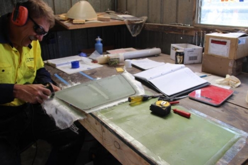

Trimmed door.
Discovered the rear overlap I have made the door on is half the required 0.2" deep. Hmmmm. Sand the required profile into the top foam. Sand the rear overlap of the door vigorously, and achive 0.15". Hmmmm. Decide to leave it for now, if required I can sand harder later, and apply more tapes underneath to replace the structure.
Routed recess for door, (no pix, forgot to turn the camera on), and sanded flat.
Marked the 0.8" flange
Trimming, trimming

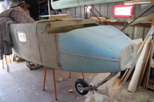

Trimming, trimming
Door hole cut
Door hole cut
Door in hole
Door in hole
