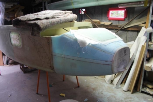

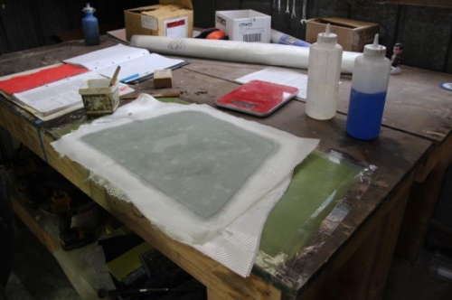

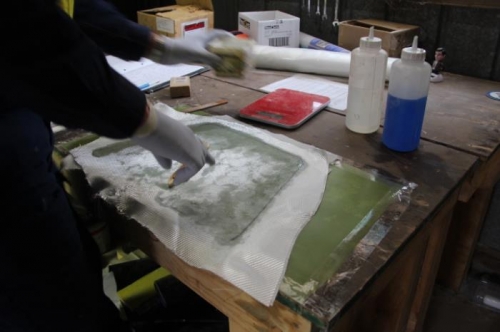

3 x BID between peel ply on the bench, onto the nose to cure. Weighted with blankets over a sheet of plastic.
2nd ply
All done between peel ply
On the nose
