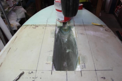

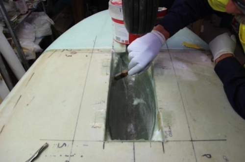

Nose gear doors
2 x BID over the ends of the spring mounting rods. Tried 1 x BID over the bottom of the spring. Didn't work well, will try flox later.
2 x BID over the hinge hardpoints, overlapping 1" onto the bottom and inside of the wheel cover.
Finished flox corner over the exposed foam, micro'd the rest and 1 x BID overall, overlapping 1" onto wheel cover and flush with the bottom.
2 x BID over the hardpoints
1 x BID overall
