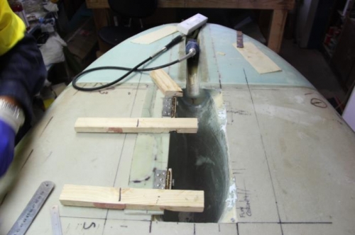

Have noticed access for drilling and tapping the STBD door hinges will be a challenge, so drilled, tapped and installed PORT door to hardpoints with AN525-10-R11 before fitting hardpoints with micro.
Cut down a 5/32 and 3/16" drill bit to access the STBD.
Fitting the inserts
Fitting the inserts

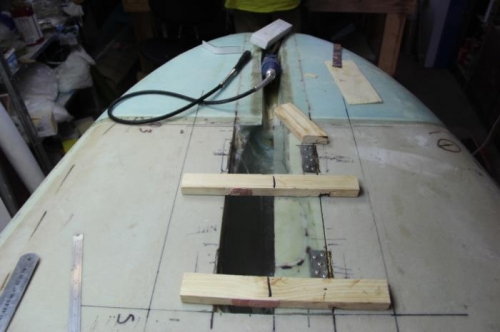

Micro smeared
Micro smeared

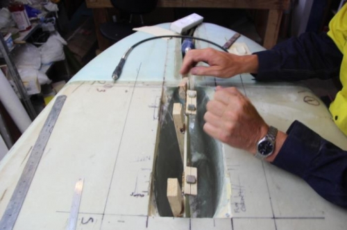

Fitted
Fitted
