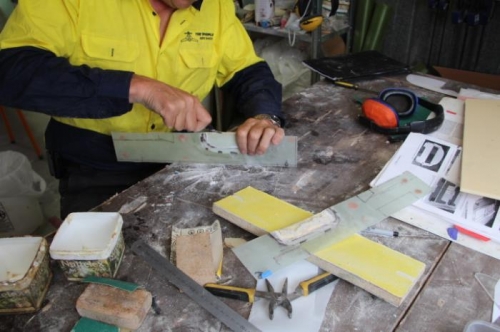

Trimmed doors and figured inside of the bump to leave about 1/8" foam.
Cut some more 1/4" H100 to 1/8" with table saw and hacksaw blade, and figured to cover the rest of the inside of the doors, leaving the hinges and around MKNG-15A glass-glass.

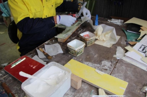

Reattached doors to thinned backing boards and left to cure in place. Didn't bond in a couple of places, fixed with 5-min and some foam scraps.
Micro'd foam to doors and 2 x BID overall, peel ply on hinge points.

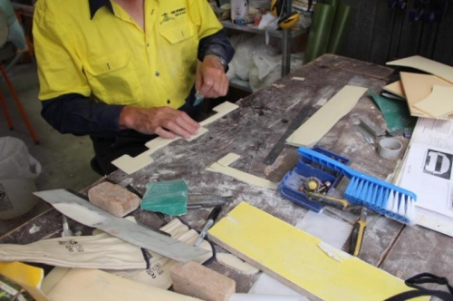

Hogged out some foam from the wheel socket bottom foam for the hinge hard points. and prepared for flox corners.
Started marking some 1/4" 2024-t3 for hinge inserts.
Opening up the inside of the bumps
Figuring door foam
Figuring door foam
Peel plying hinge points
