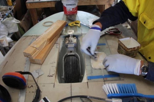

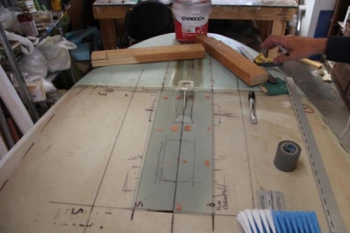

Had difficulty managing the backing boards with the nose gear foot, so adjust the boards.
Note nose strut cover is a bit proud aft, and sand back the SC tapes a bit to adjust.

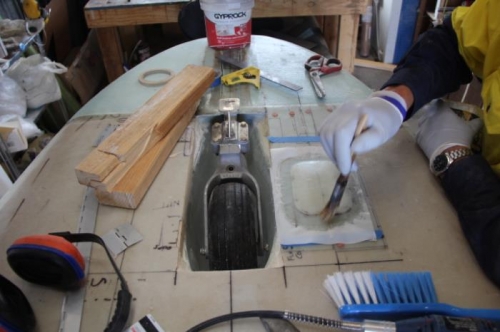

With the stut cover flush am surprised to discover the nose wheel interferes with the doors. Pop them off the boards and make a bump from 1/4" H100.
Tape together the doors, with a multi-tool blade gap, and tape the gap with 1/4" masking tap. Install bump with micro and cover with 2 x BID with 1" overlap and peel ply.
