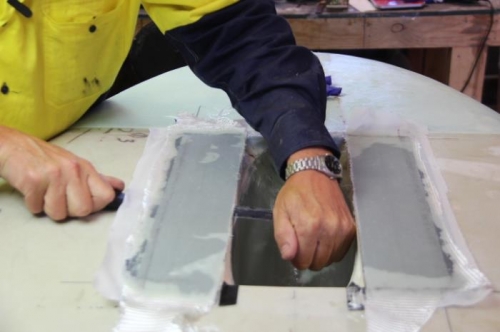

Doors still a little tacky, and stuck to grey tape like sh!t to a blanket. Was easier to remove by inserting Viki's biscuit lifter UNDER the tape. Scissor trimmed doors as they were tacky. Re-taped fuselage AND doors and put back into position. Bondo'd boards over the top to hold their shape when removed. Think it may have better to leave them for more curing, they may pop off easier then.
Taped off unbonded area of nose strut, leaving 3/4" for the bonded portion. Taped off a couple of inches all the way round near the end.
Faired the junction of the strut and the inner side of the outer cover with flox, then 2 x BID over the strut and 1 x BID along the sides. Clamped the resulting 3 x BID over the strut, as it won't lay down.

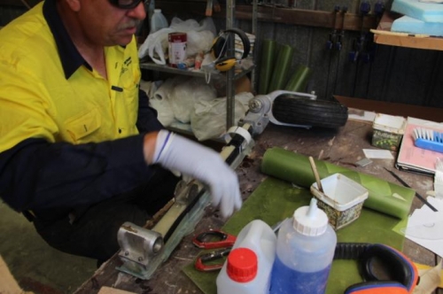

Pinched a tool form the kitchen. Cleaned carefully :)
