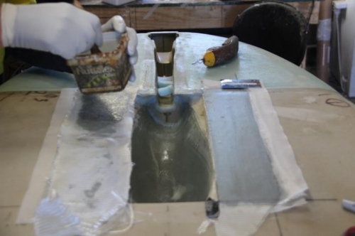

Acknowledged that the fuselage is too high on the table, and utilise some visitors to move the fus onto sawhorses.
Apply a flox corner and 1 x BID over the fwd wall of the wheel hole, taping 1" onto the nosewheel cover, SC, F-22 and the nose bottom where I cut SC yesterday. The last had another 1 x BID, with 1/4" overlap, bit of an experiment really.
2 x BID between peel ply over the grey tape for nose wheel doors.

One door done, wetting out the second
