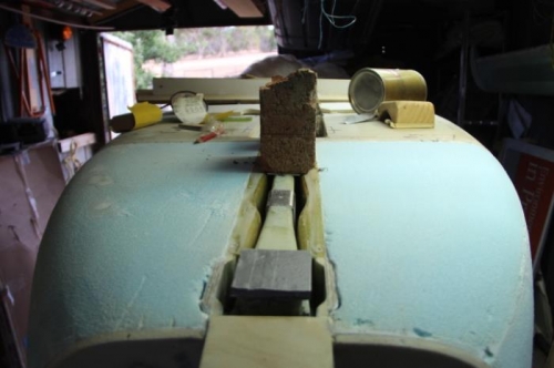

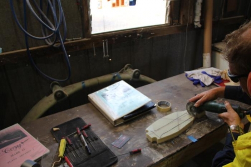

Shaping the nose
Used an offcut of bottom foam to make a packing piece for the nose strut. Attached it to the strut adapting the Wayne Hicks method, 5-min to the strut from 3-4" below NG-3 with a fillet of RTV below that. Weighted for cure.
Cutting the packing piece
Weighted for cure
