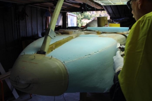

Adjusted bottom profile and final sanded lower nose. Managed to get some ugly elbow holes on the STBD bottom...

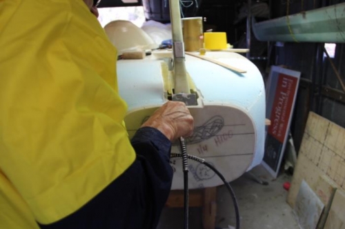

Cut Nose Bumper support from 1/4" Hoop Pine ply, taking two goes to get the bevel right.
Hog out the mounting point for this so it all fits under the Nose Cone.
Floxed on the mounting point, and floxed on SC, secured with plasterboard screws.
Used leftover resin to micro bits of foam in gaps, and filled the elbow holes.
Making room for Nose Bumper support
filling gaps
