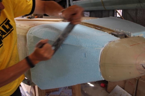

Spent a bit more time playing with the bracket and contemplating the Nose Cone.
Inverted the Fuselage, still possible solo with the sawhorses handy.
Shaped lower nose by eye with sureform and sandpaper.

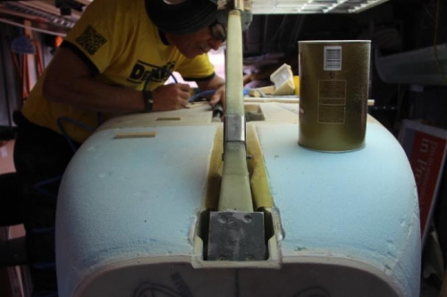

Trimmed Nose Wheel cutout surrounds on bottom, pranging the attaching tapes in a couple of places.

Starting Nose Shaping

Trimming Nose Wheel cutout
