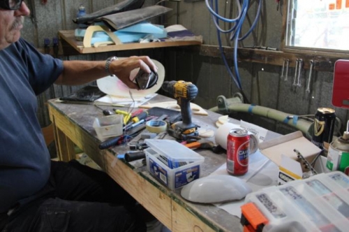

Brief Description:  Nose Cone
Made a mounting plate from 1/16" 2024 t3, aiming to fit the light mount to the Nose Cone with clickbonds. When I try it out it does not suit the complex curve. May work better to have a fore/aft mount, secured at one end with a tab in a socket.
Decide I have wasted 2 weeks playing with the crap that I do not need yet, having figured out I DON'T need the Nose Cone in place before skinning the nose. I may play with the window concept shortly, but the rest of the nose is the priority.
