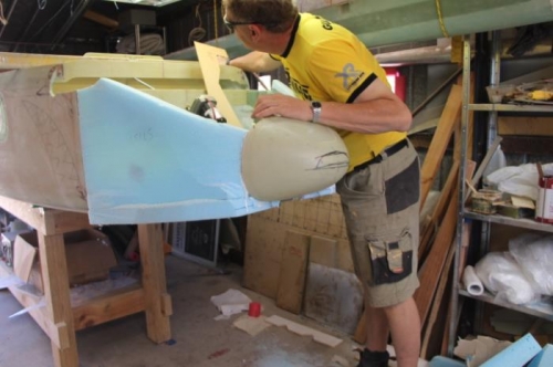

Decide to form a flange by attaching some foam inside the nose bowl, glassing the inside, then forming the required shape on the outside, and taping it all up.
The only critical thing at this point is I need a mould of the inside of the nose to make a nose window from sheet acrylic, drape moulded, and I need to make and test this before destroying the inside of the Nose Cone. Want the pleasantly ugly shape of a BAC Strikemaster headlight. Just because.

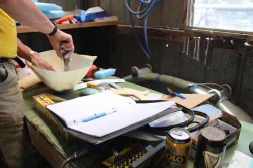

Line the Nose Cone with polythene film and squodge in some plasterboard jointing material, for a window mould.

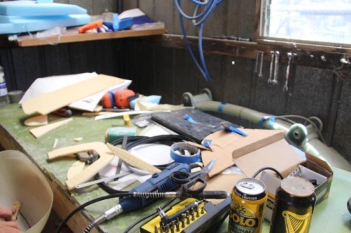

Spend some time on W&B and estimate I need 2 x 440ml and 2 x 375ml cans of lead for the first flight. Only need room for 2 x 440 and 1 x 375 in the Nose Bowl. Possibly doable.
Getting my head around the nose light window
Playing with foam and cardboard and cans of lead
Plastering!
Plastering!
