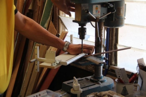

Fixed rudder pedals to a jig and drilled/reamed for AN4 bolts.

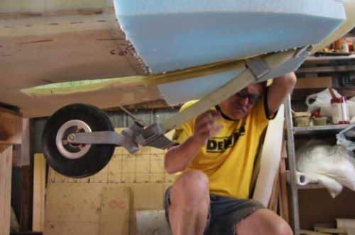

Bolted rudder pedals up with temporary hardware bolts and installed. Looks like I achieved 4.5" travel, which is less than I expected, but more than I need. All seems suitably rigid.
Cut slot in SC an trial installed. Discover I have removed too much from F-22 and will have to pack it. NG-1 is a very tight fit at F-22, will need a better look at why, and maybe have to relieve NG-30 a bit. Will wait until Fuselage is next inverted for a better look at what is going on.

Drilling out the rudder pedals
Rudder Pedals temporarily installed
Seeing if SC fits. It doesn't.
