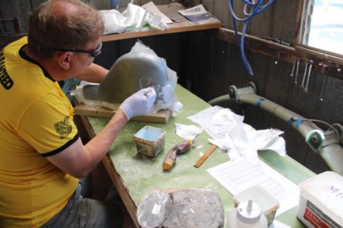

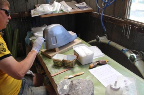

Prepared exposed foam over air diverter, 3 x BID over nose gear cover plug, peel ply edges and exposed dart.
Installed Master Cylinder hard points from 1/4" ply with micro. 4 x BID overlapping 1.5" around. Peel plied edges.
Micro the foam, plug covered on its stand
2nd layer, dart at rear, other layers had dart at side.
