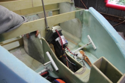

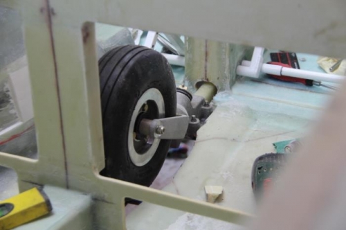

Extended the gear, (manually), and smoothed the hole.
Relieved F-22 a bit until it looks nice and NG-1 contacts the rudder torque tubes before anything else.
[Timewarp 18NOV2015: Took out too much, leaving a gap between F-22 & SC, will have to pack it out, after permanantly fitting SC]
Trial fitted the manual extension tube to the noselift, and found it a lot easier to operate than the simple bar I had been using. Installed the manual extension tube.

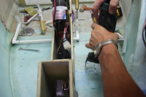

Set up the Rudder Pedals again, and fixed a location for the Master Cylinder mounts. Hogged out the foam.
Hole a bit smoother, and good clearance

Hogging out Master Cylinder mounts
