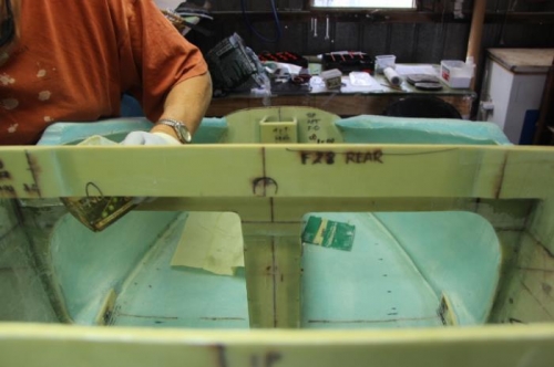

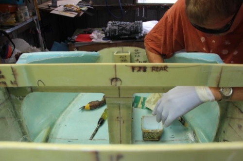

Removed the Rudder Pedals, cleaned up the flox lumps and bumps and sanded surrounds. Wound the Canard bolts out a bit until the end is flush with the back of the nutplate, and put a dob of assembly grease on the end. Put a small piece of masking tape over the Rudder Pedal nutplates, and marked the centre.
Bogged up gaps, prepped the foam and faired the back of the Canard nutplates with flox.
1 x BID over the back of the Canard nutplates.
3 x BID over the Rudder Pedal hardpoints, using up ALL my BID scraps.
Peel plied all edges.

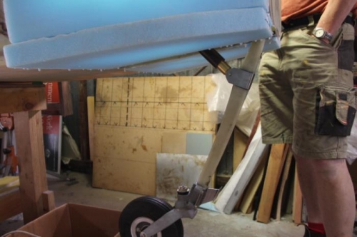

Trial installed EZ Noselift & Nose Gear, (without wheel). Extended gear and checked castor roughly, looks OK.
Retracted gear manually until nose fork touches fuselage. Way fun.
Bit hard to see, BID over the Canard nutplates
BID over the Pedal mounts
Nose Gear down and locked!
