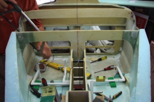

Removed Canard.

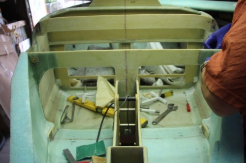

Despite clamping the forward face of CNL is not flush with F-22, filed it flat, pausing when I thought I was putting in too much heat.
Cut excess of rear of CNL with hacksaw, and filed it flat too.
Trial fitted Canard and checked alignment/incidence, all is good.

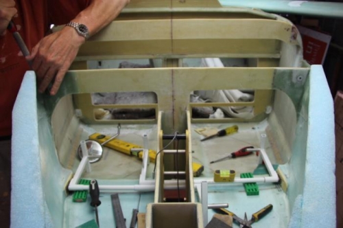

Floxed on front Canard mount nutplates, clamped with AN-4 bolts. Big shifting spanner was good to hold the nutplates square while tightening, at the cost of getting flox all over it.
Filing FWD face CNL
Filing FWD face CNL
Trimming rear face CNL
Floxing on nutplates
