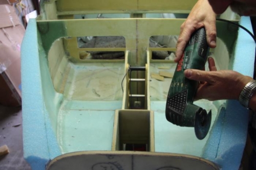

Trimmed last layup. At the top of the sides I trimmed back to the dished out part, it can be taped up later, when the inside profile is decided.
Opened up Canard mount on F-22 to 5/8" with holesaw and inserted CNL bushings from CG Products, my last little shiny thing in the box from them. Thanks Ladies!
Fitted the Canard, and noted the rear tabs are now wide of F-28 by the thickness of the 3 x BID I have just put over the front tab pad. I do note the rear pins are all the way through the rear tab CN-2 bushings, but am worried about the gap, and wonder if the Canard alignment has been affected also. Time for research and maybe a question on the forum.
Note I needed more Al cut an prepped for the Canard attach nutplates, so back to the other shed.
Trimming, trimming
Trimming, trimming
Trial fitting CNL bushings
