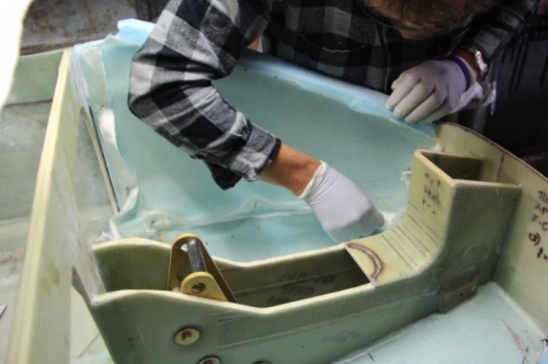

2 x BID over inside of nose sides, leaving overlap unwet, which I tucked up, and let cure for a bit.

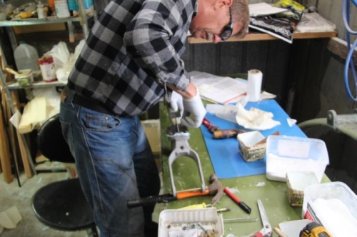

Floxed MKNG-15A & MKNG-2 onto Nose Strut, bolted up with AN4-13, plans screws not available. Can't make sense of the 10"lb torque the plans demand, it need more than that to rotate the bolts. Ended up about 25"lb.

Micro'd the nose sides and wet out the overlapping BID. This worked REALLY badly, and I wish I had done it the way I wanted, like the fus bulkheads, glassing the sides, then mounting them and taping them after cure. Ugly, with lots of voids I can't reach.
