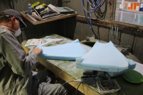

Sanded PORT nose side to match the previous STBD.
Trial assembled with Rudder Pedals in place and not terribly comfortable with the whole setup. Pedals seem to interfere with the sides far earlier than I expected. Occurs to me I don't really know how much travel they need, and there is the braking advantage debate with the Oelmann pedals that I don't really understand either. Research time.
Matching up the PORT side
Hmmmmm. Pedal is inboard of where it should be and still hits side after 2
Hmmmmm. Pedal is inboard of where it should be and still hits side after 2" travel. Hmmmmm.
