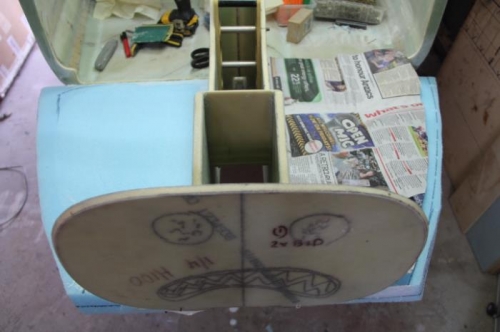

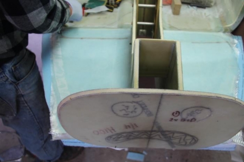

Glassing nose floor
Bogged up gaps around nose floor foam.
1 x UNI (plans say BID) over heel area then 2 x BID over all. Plans sort of imply it should go to the edges, but I stopped it short of where the insides of the sides will be to make it easier to shape the outside of the nose.
Cutting template for BID
Micro, micro
Peel ply the edge
