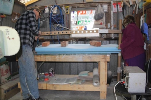

Brief Description:  Nose floor
Hot-wire cut the blue wing foam into 2" slabs.
Trimmed PORT nose floor and rather proud of my work.
Try to trim the other, AND DISCOVER I HAVE MADE TWO IDENTICAL PIECES. What a dingbat! Made a new STBD floor. Estimate that due this, and farting around with the Elevator cores I no longer have enough foam spare to do the nose. May have to see if the Wings will leave any spare, or make the nose top out of bits.

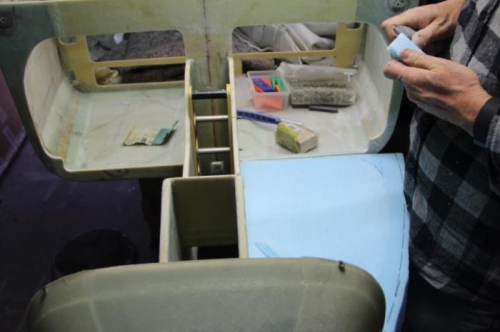

Micro'd both floors onto nose, fair bit of drippy mess.
Stuck some foam along the back edge of F-22 to fair to the bottom of the fuselage. Steamed about this for a while, would have been easy to make it the right height from the start in CH06.
