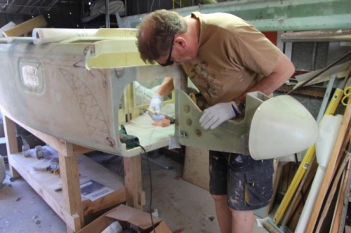

Trimmed yesterday's stuff. Was startled to discover the timber bracing F-0 cannot be removed without cutting it up!
Tempo fitted Feather Lite nose bowl for fun.
Prepared and 2 x 2" BID taped rear of F-22 to NG-30.

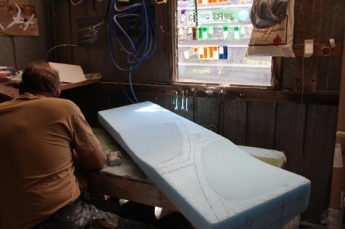

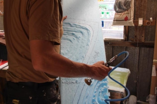

Marked up nose floors on a block of wing foam. Dished out the centres with router, rotary wire brush and sandpaper. Incredible mess. Will hotwire it into 2" slabs when I can get a helper.
[Timewarp 16/10/2015: If your floors look exactly like mine you have made a horrible mistake, read on...]
Taping NG-30 to F-22
Smoothing router cuts with rotary wire brush
Ready to cut up
Ready to cut up
