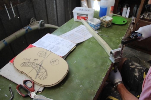

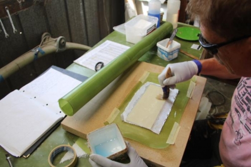

Cut out F-0 from 1/4" H100, applied 1 x BID on AFT face, 2 x BID FWD and weighted for cure. Checked Feather Lite nosebowl for fit.

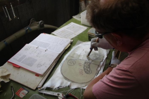

Cut out F-5 from 0.2" 18lb foam, intending it to curve around the NG-30 onto the horizontal bit. Coz I want to. Applied 2 x BID on FWD face & peel ply and weighted for cure.

FWD face F-0
FWD face F-0
F-5
F-5
