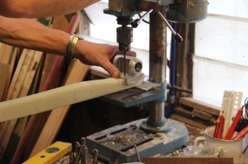

Disassembled Nose Strut assembly from NG-30 & cleaned it up.

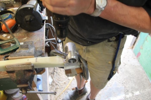

Drilled Strut assembly and NG-5, (made last year), and countersunk. Started the holes in the drill press, with the strut propped to make the face of MKNG-6 level. Finished holes with hand drill.

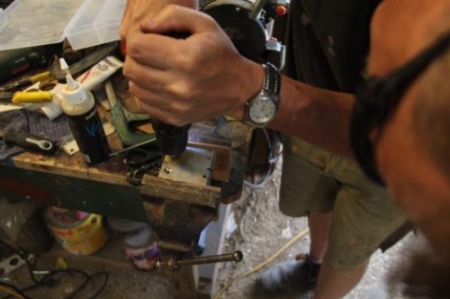

Discover -70 cs screws are nowhere near long enough, thankfully I have -72, but will require massive cs at rear. Screws are a very tight fit in holes reamed to 3/16", assembly lube helps.
Drilling, drilling
Drilling, drilling
Drilling NG-5 through the strut
Countersinking NG-5
Countersinking NG-5
