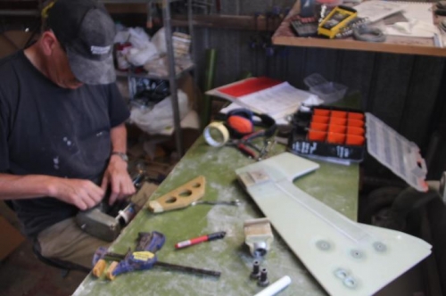

Have had a bit of an agonise about how to drill the NG-51, and have come to the conclusion that I can't be definitive. The plans have you use the manual gear NG-51 as a guide to drill the NG-30, I need to do it in reverse, with no holes to start with. The geometry seems good, so ensured sufficient edge clearance and drilled NG-51 to match the original NG-30 pilot holes, with all the bits bolted together.

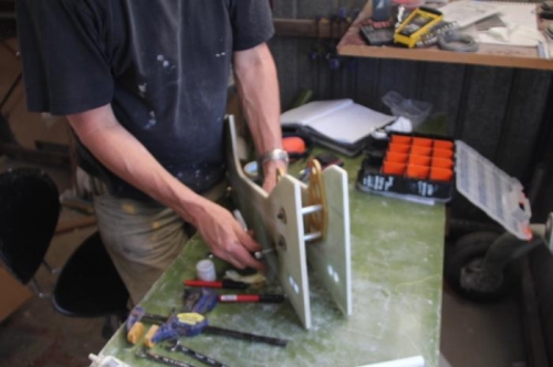

Made another NG-14 to match the first.
Taped off outside mating surface MKNG-6 and assembled onto NG-30.
Assembled NG-14/30 without Noselift. Relieved NG-30 a bit to avoid interference with the head of the Noselift.

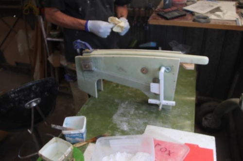

Floxed NG-1 onto MKNG-6 and clamped, strut supported on Rudder Pedal torque tube, with a MDF spacer.
NG-51/30 holes all drilled
NG-51/30/14 assembled
NG-1 floxed onto MKNG-6
