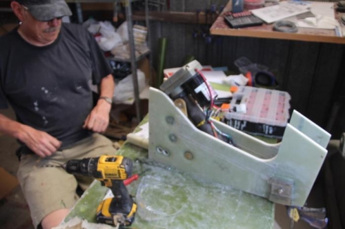

Brief Description:  Trial assembly NG-30

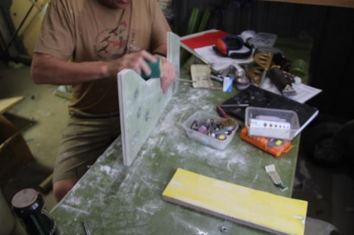

Trimmed layups, bolted NG-30 together and sanded to same profile.
Drilled/reamed MKNG-6 pivot out to 5/16".
Assembled NG-30 around MKNG-6 using AN5-50 bolt, which will require AN960-516L washers, which I don't have. Using the thin SS washers that come from the upper Noselift mount. To get the separation between NG-30 at the NG-51 location requires two AN970-5 wide area washers either side of the MKNG-6. This makes the spacing between NG-30 2.95" at the FWD end, (which has thicker plies), and 3" AFT.
Adjusted NG-14 to 2.5" length, and assembled Noselift into NG-51, separated by NG-14 in the bottom holes, where it shouldn't be :)
All seemed kosher.
Match sanding
Match sanding
