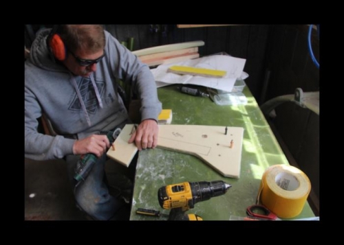

Trimmed NG-30 some more and sanded sides flat. Layup is still a bit gummy, it is really cold here.

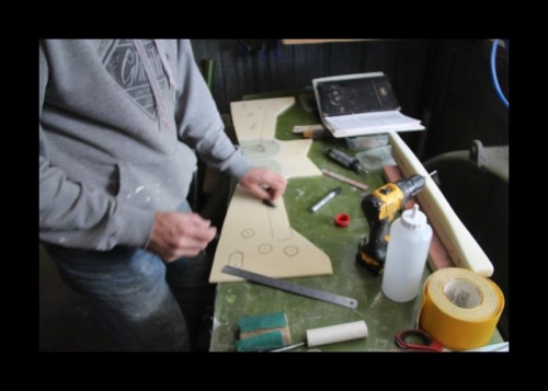

Marked out hardpoint cutouts, the wheel bearing spacers that came with the wheels are just the right size. Is hard to be certain, but believe I have the locations right for the EZ-Nose Lift, as compared to the plans manual system. It may not be required, but I am putting in hard points for the rudder pedal torque tubes too. Plans just say drill holes, and other fit bronze bushes in the NG-30, which mean you have to grind off the lovely powder coating on the Oelman pedals, no thanks! Figure I have some 1.2" plastic pipe in the shed, will make a foam cutter from that.

Trimming NG-30
Trimming NG-30
Marking the NG-30 hardpoints
