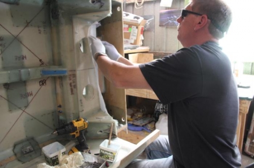

Superglued AN960-816L washers to MG-1 Bushings, AFT - STBD, FWD - PORT, to achieve the toe-in planned a month or two ago. Initially placed wrong due to enigmatic labelling on fuselage bottom.
Sanded off delam on lower edge, replaces with 2 x BID.
Floxed in MLG Inner Cover and taped top and bottom. Plans imply this should be done with the gear installed, which means, (I expect), you aren't supposed to tape the bottom. Remembering the mess I made with the AFT NACA foam I had the gear out to figure the flox nicely, and taped them as well.
Peel plied tape edges on inside only.
Faired in the bulkhead fittings with flox.
Used leftover flox to repair re-figured MLG fus cutout, didn't log when I did this, but it was just after the Australian Canard Muster. 2 x BID over this.

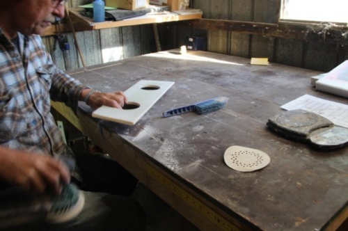

Sanding off delam
Sanding off delam
Cutting some more 2

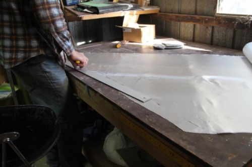

Cutting some more 2" tapes
Transferring tape on peel ply
