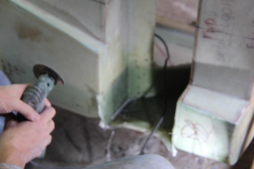

Cut MLG Box to length on PORT side.

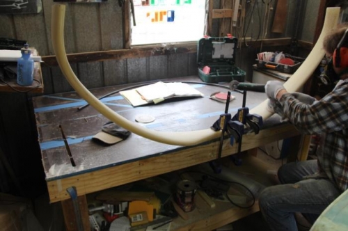

Sanded strut dull with 40G USING random orbit sander.
Mounted strut leading edge down, 5-min/floxed to three 75x3mm nails hammered into the bench.
Trimmed last fuselage reinforcement. Left it a bit rough around the strut, make it nicer later.
Started to cut UND for Strut torsional wrap, ran out of UND after 5, need another 8.
