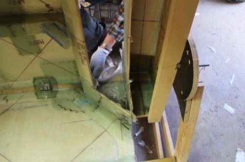

Fuselage reinforcement
Applied 5 x BID between the FWD and AFT MLG Bulkheads, along the fuselage side. Wet out in place, then trimmed with elecky scissors.
Stipple, stipple
