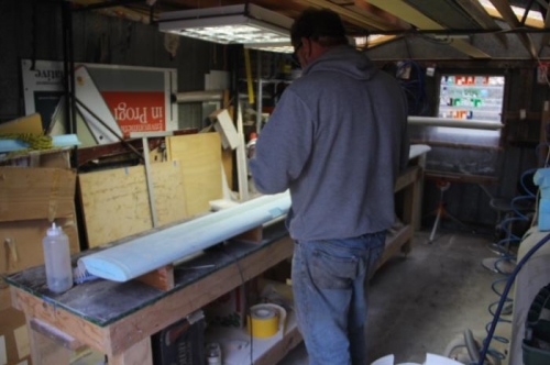

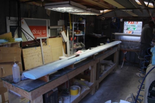

Sanded back what was to have been the final fill and created a huge divot with the edge of the sanding board.
Cut out divot and surrounds and micro'd in a bit of replacement foam. Leftover micro effectively hard-shelled the canard and touched up a couple of remaining dings and flat spots.

Final final fill done...
